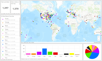

  1. Favorite Color dashboard
    This is a relatively simple dashboard, but is included here as it was the example used above. It does have some interactions between the chart and map.
    view it live | make your own copy

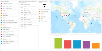

  2. Favorite subject dashboard of multi-select Survey123 data
    This dashboard takes multiselect (comma-delimited) Survey123 data and uses data expressions to examine the first choices as well to examine the sets of choices made without caring what order they were made in. It also uses Arcade to format list displays and colors, and filter to restrict the data include in another list and an indicator.

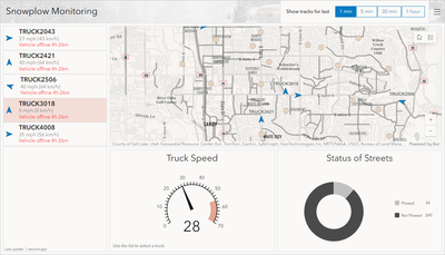

  4. Snowplow monitoring
    This dashboard uses Arcade to calculate information not included in the data (speed) and presents that value. It also uses Arcade to set the color of the items in the list and to draw attention to key values.
