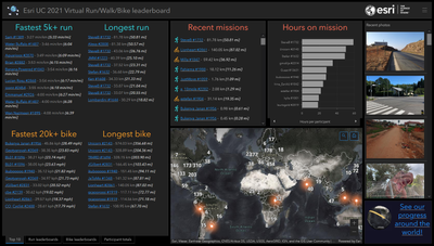

Maybe you saw a dashboard that had a list, gauge, chart, or another element that you wanted to mimic in your own dashboard. Or perhaps you saw a dashboard that you wanted to improve upon. You can make a copy of the dashboard, leaving you with your own version to edit and modify. In your copy, you can configure each element and explore the settings that the author used to create it. This even includes any Arcade the dashboard uses to make more complex displays.

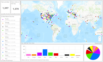

    For example, my favorite color dashboard is at https://arcgis.com/apps/dashboards/8b1b186fe52c435e95c0301997d271f0. It's ID is 8b1b186fe52c435e95c0301997d271f0.
