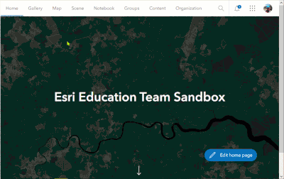

Part 2: Add your published CSV to the map
  1. Log in to ArcGIS Online and open Map Viewer.
  2. Click Add > Add layer from URL.
  3. Paste in your URL (click Control-V on your keyboard) and click Next.
  4. Choose Reference the file from the URL and add it to the map and click Next.
    By referencing the file, changes you make to your Google Sheet will appear in the map.
  5. In the Fields dialog, accept the defaults and click Next.
  6. In the Location settings dialog, make sure the fields with latitude and longitude in your spreadsheet were correctly identified. If not, correct them.
  7. Click Add to map.
Your data appears in the map! The information from your spreadsheet is available in the pop-ups. Now you can customize the symbology and pop-up, making a great map of your data.
