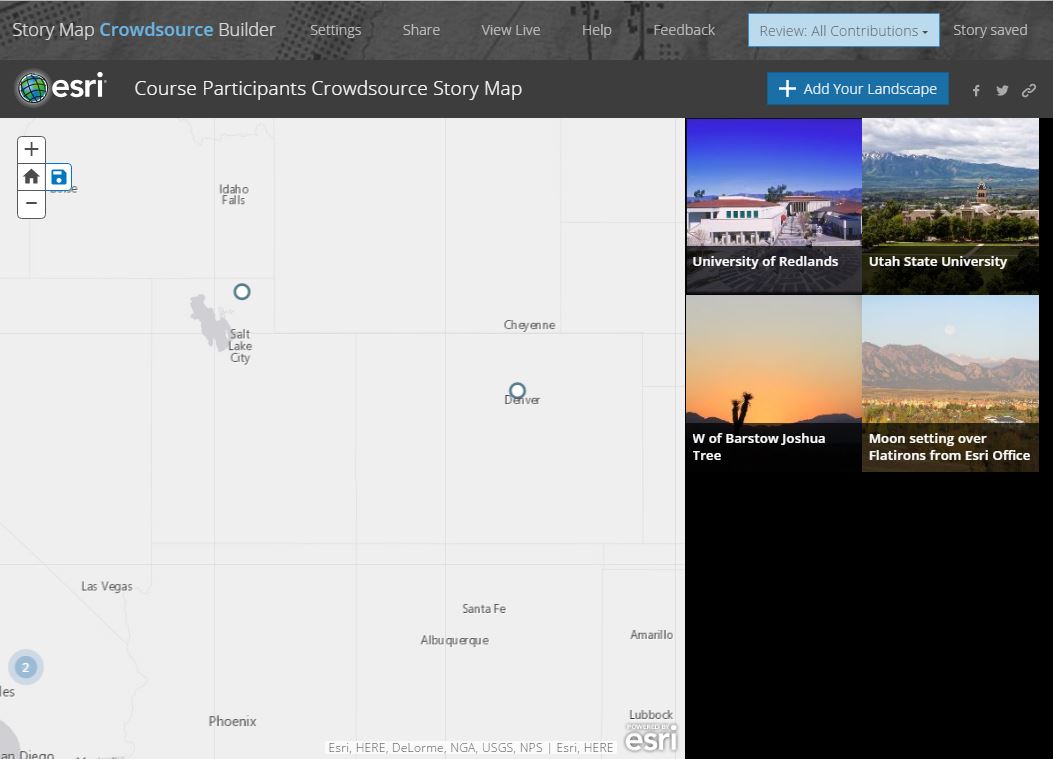

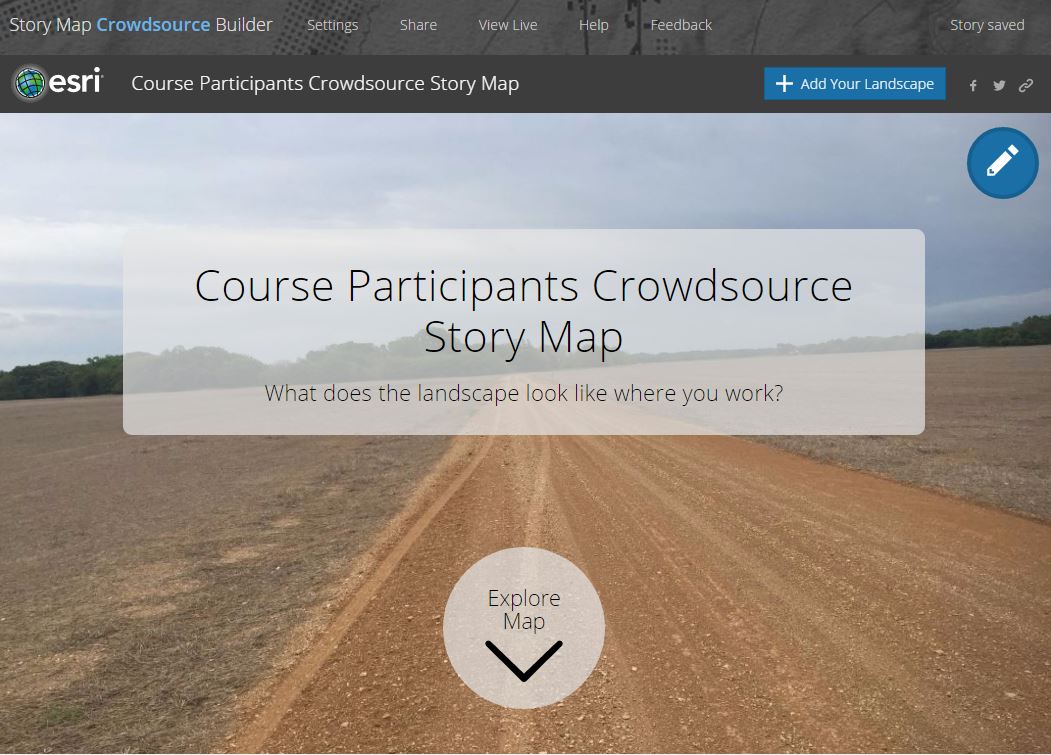

I have been using crowdsource story maps frequently as a networking tool in face-to-face and in online courses.  For example, I ask the participants in these courses to add a photograph to a map that shows the view out their window, shown below and linked here.  The first screen indicates what they are to do and displays a "Add Your Landscape" button in the upper right:
Crowdsource story map - front screen
The map allows us to have discussion on the diversity of landforms, land use, vegetation, and weather in the location where the participants work.  It also allows us to have a discussion on web GIS, story mapping, and how crowdsourcing works.  We discuss ideas of what they could do with crowdsourced maps--from mapping trees, shrubs, litter, or light poles on their school or university campus, broken sidewalks, "little library" kiosks, or pedestrian counts in their community, locations of major tsunamis of the past century, or to conduct a brief poll in class (indicate 1 location in the world where you think that water availability (or biodiversity loss) is at a most critical need right now), or other data from local to global scale.  Some of the responses on my web map are shown below, including my own photograph from the Esri building in Colorado:

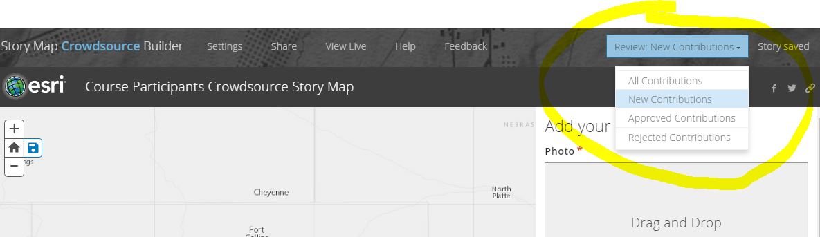

Go to the story map that you wish to edit.  It is easiest to use the "My Stories" zone on http://storymaps.arcgis.com.  Edit your story map, and look in the upper right under "review new contributions."  You can review and approve all of them here, or only the new ones since you last reviewed.  In my case, I want to delete all of the contributions so I can use this map for another course with new participants.  I would therefore select All Contributions, as shown below:
Crowdsource Editing, continued...

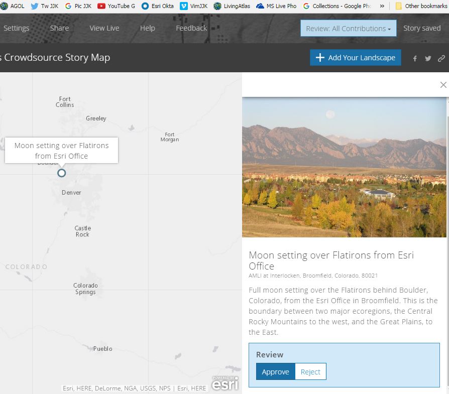

Then, I select each of the contributions and reject, including the beautiful photo I took in Colorado, as seen below:
