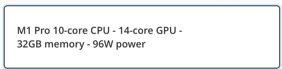

I am looking to get this configuration
I don’t do a lot of processing activities, basic editing but looking to do more in 3D
this 512 GB one so should be able to store Parallels machine on the hard drive, unlike my current 128GB Macbook Pro
this is in stock from place getting from, was looking at 16 core GPU but that is 6-7 week wait time

Any advice on above specs?
MarcelSt-Germain
As always,
For what purpose?  Studying, play with or doing professional works?  Do you need this configuration for native Mac works like video editing?
If not for professional works, you have enough memory to allocate 20 GB to VM so, it can do the job.
If you bought this configuration only to work with Pro, you are in gambling thinking since Microsoft could stop anytime the access of ARM windows and only release an OEM version.
If you don't need this power to drive Mac's work, the more secure option is to buy a smaller configured Mac and use the money saved to buy a cheap PC to run natively Pro.  Personally I'm a Mac user since 1985 but, use Remote Desktop to drive Pro on a PC.

to @JonathanHallam1 : your specs are just double compared to mine. I think an M1 Macbook with 32Gb of RAM and 1TB of SSD is the best option for "normal" ArcGIS Pro using, but I'm able to do all my work also with 16Gb of RAM and 512 GB of ssd, never get an hick or crash (I'm working with 3D, Utility Network, Diagrams, Geoprocessing, build and debug AddIns)
There's a but (there's always a but...): as someone else said on this thread, the ARM version of Windows used by Parallels is an insider version, so maybe will be available to the public, maybe not (Microsoft use it for his ARM laptop surface version) and there's no supporto by ESRI for this kind of configuration, so if some errors comes out (like the one about C++ runtime) you are unable to open support cases.

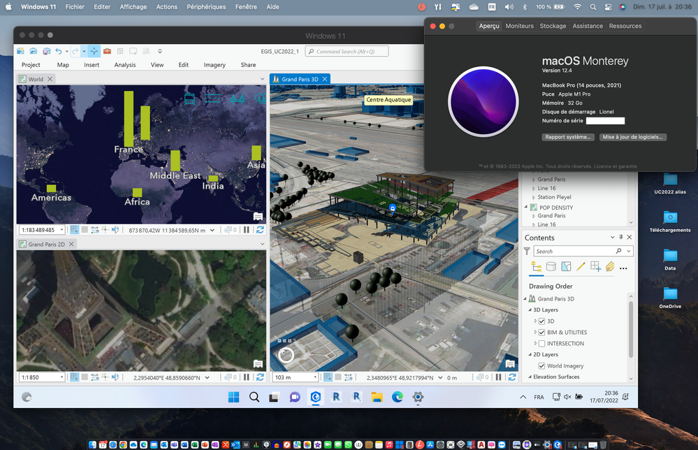

@AMoyers Attached a screen shot of ArcGIS Pro on Mac M1 Pro with Parallels Desktop. It works quite well even in 3D. BTW, this is the project done by Egis (French engineering firm) that was presented during the UC 2022 plenary, who runs on both my Mac and my PC. However, the use of ArcGIS Pro on ARM  is not supported, so cannot be used for production.ArcGIS Pro on Mac M1 Pro with Parallels DesktopArcGIS Pro on Mac M1 Pro with Parallels Desktop
AMoyers
@LionelHenry_EsriFrance that is really great to hear, I thought this was going to be really painful.  I think I must have missed @EmilianoPetrelli's response on this because it's clear he's running this also.  I was able to get this installed, it looks like a .NET runtime problem was preventing it from running, either because the ARM64 runtime had a corrupted install or was not compatible.  The second time around I installed the runtime for x64 architecture which installed and Arc Pro is running now.  Most of the analysis I'm doing is basic, I'm not too concerned about performance but it's greatto hear that you aren't noticing any significant differences.
