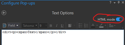

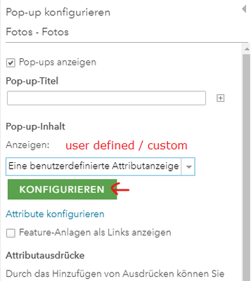

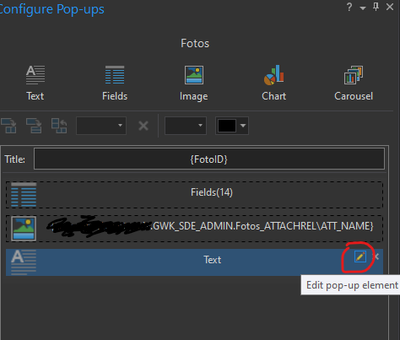

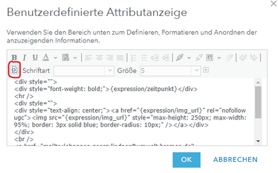

When you configure your popup, there is an option to switch to the HTML source.
ArcGIS Pro:
Map Viewer Classic:
