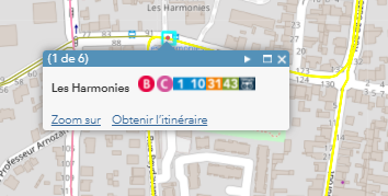

Hi Johannes, it works like a charm!

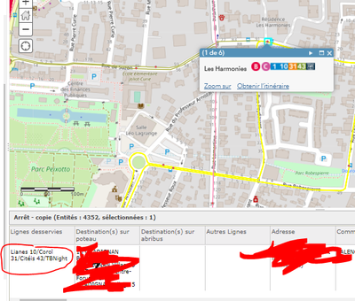

But I Have a problem with the Find fonction: it finds me every word beginning by a B or a C as we see in the image. Even when my line calls 1 or 11, it finds the both.
How can I solve this little problem? I have tried with the lenght of the value or a other value of a other field but I didn't success.
If you have any idea, it would be very nice ! Thank you

If your lines are always separated by the same character ("/" in your image), you can use this:
// show_line_1
var lines = Split($feature.LineField, "/")
return IIF(Includes(lines, "Line 1"), "block", "none")
If Includes is not available for you yet (it came with the latest Arcade version), it would be a bit more cumbersome:
// show_line_1
for(var i in lines) {
  if(lines[i] == "Line 1") { return "block" }
return "none"
Have a great day!
Johannes
