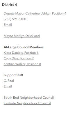

John_Shell
Hi Pedro,
The issue is at the bottom of the pop-up when it lists out the names of the intersecting areas and the hyperlinks do not work correctly.
Link to WebViewer: https://tacoma.maps.arcgis.com/apps/mapviewer/index.html?webmap=c80eda9c8e434844a8ddbe742fc11a9c
Pop Up below
