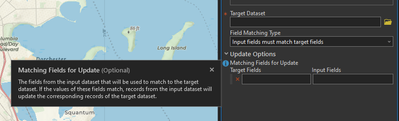

Hi @ITAdmin ,
I would recommend using the Append tool in ArcGIS Pro.  With the latest version of Pro, there is a Matching Field for Update option:
This will update existing features based on a unique field.  If the feature does not exist, it will Append the new feature.
If there is not a unique field, you could execute the Truncate or Delete Features tool first, and then execute the Append.
