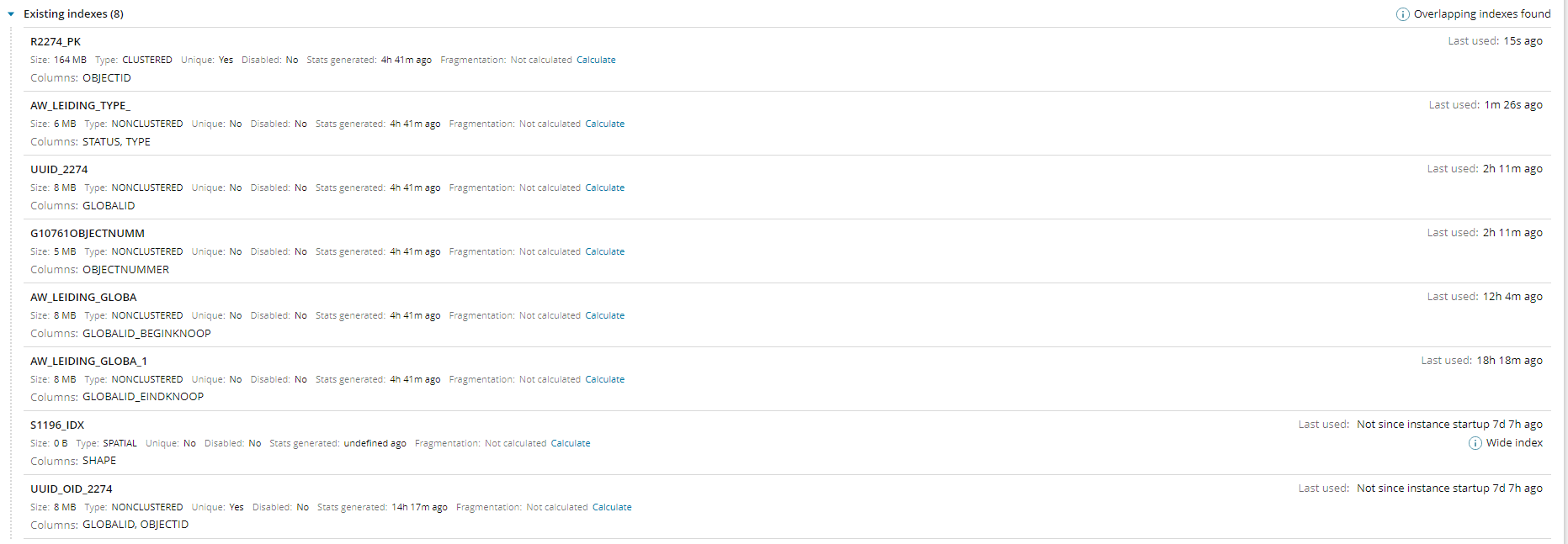

Now Solarwinds reports that the spatial index is not used on this table:

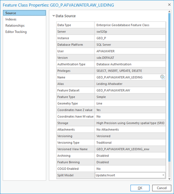

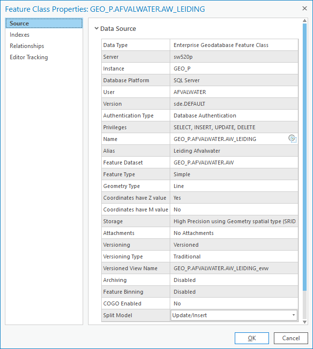

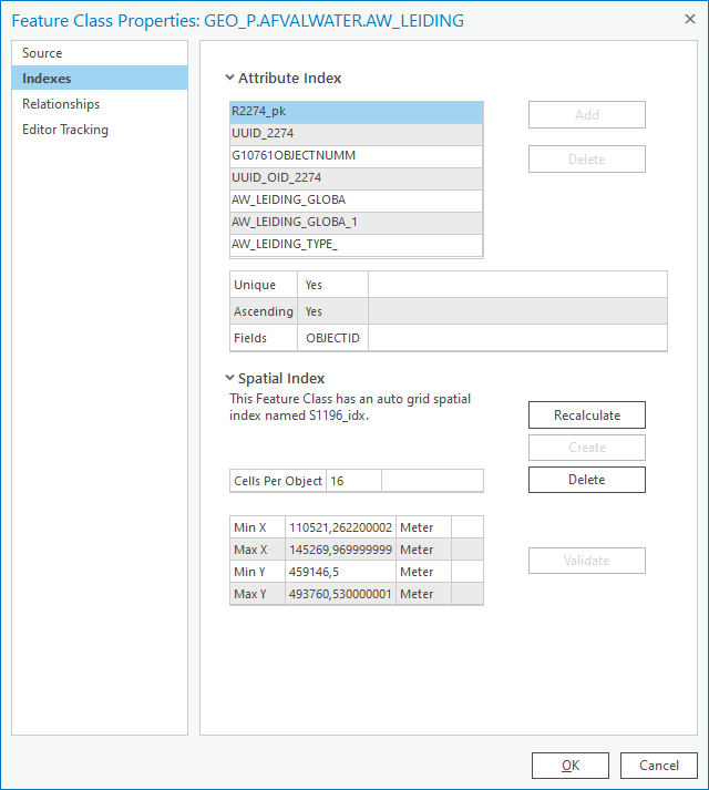

Here is the Featureclass from ArcGIS Pro:
The Featureclass has a good performance, the table has 249817 records and rendering in ArcGIS Pro is less than a second zoomed at large scale with a few records and around 5 seconds when all the data is rendered on the map. Therefore my colleagues and myself think the spatial index is being used and this is a false warning from Solarwinds DPA.
