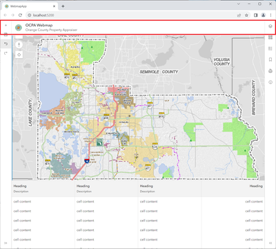

ForrestLin
Hello Mark,
Thank you for your help.
We want layout like this:
There are some issues, which I'd like to discuss with your colleagues and developers for calcite there.

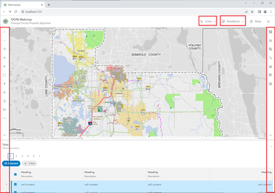

1. Sub menu <calcite-menu-item slot="submenu-item"> doesn't work.
2. Action group <calcite-action-group> doesn't work.
3. Scroll bar of table doesn't work.
4. Pagination <calcite-pagination> can't place on the right (end)
5. Shell panel <calcite-shell-panel slot="footer" position="bottom" layout="horizontal" resizable> can't be resized.

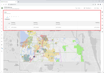

6. If I set slot to "panel-bottom": <calcite-shell-panel slot="panel-bottom" position="bottom" layout="horizontal" resizable>, the bottom is above map:
ForrestLin

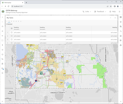

It is OK if the display mode is float. But it's not on the bottom.
<calcite-shell-panel slot="panel-bottom" position="bottom" layout="horizontal" display-mode="float" >

This issue is resolved by adding:
<calcite-shell-panel slot="panel-top" />
