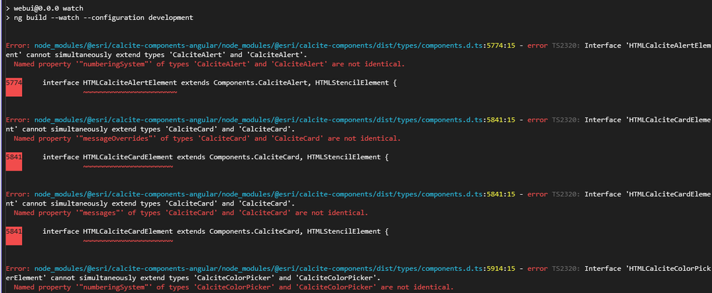

Failed to compile with calcite-components-angular 2.0.0.
No problem to compile with calcite-components-angular 1.11.0.

I am having the same problem with esri/calcite-components-angular 2.4.0 and Angular 16. By chance did you resolve?

Hello Shane,
I was able to resolve this issue by adding "allowSyntheticDefaultImports": true to the tsconfig.json file for the app, and running 'npm i --save-dev @types/sortablejs'.
Hopefully this works for you.

Hello Mark,
I have resolved this issue by adding "allowSyntheticDefaultImports": true to the tsconfig.json, and running 'npm i --save-dev @types/sortablejs'. But I'm not able to show the map.
