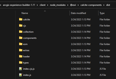

Without seeing your code, I don't know what you already have.
Is your import like this?
import "@esri/calcite-components/dist/components/calcite-button";
import "@esri/calcite-components/dist/calcite/calcite.css";
and your file structure like this:
KittyHurley
