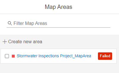

I'm having an issue with the Workforce Mobile App only showing the Assignments and Workers layers, and not any of our organizational asset layers. I want our inspectors to be able to see our stormwater assets in the Worker map in the mobile app as well as the their assignments. The stormwater layers consist of four rest services published from arcgis server via ArcGIS Pro to our server site. The layers are feature services with sync enabled (not sure if this matters?).

@SterlingLoetz What happens when you try and create a Map Area, using the web app, for the Worker web map?  Are the layers included?
SterlingLoetz
@CraigGillgrass the offline map area creation fails. I've tried in a couple different geographic locations at various levels of detail, and all fail. There is no particular error thrown, it just shows as failed.
