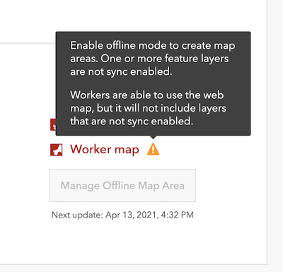

CraigGillgrass
Karina, Sterling,
A few things to check:
  • I'm assuming you're using the new version of Workforce and not the Classic version but can you confirm with provide the app version?
  • If you are using the new version of Workforce - it is built for Offline support only will only display layers that are sync-enabled.
If you take a look at the Overview tab when you configure the Workforce Project; if you have layers that are not sync-enabled in the Worker web map - you'll see this warning:
Does any of this help with what you're seeing?  Can you confirm if you see the a similar warning to what I've posted in this screenshot?
Craig 
SterlingLoetz
Thanks for the reply Craig. Currently I am using mobile app version 21.0.1 build 275 on Android 11.
I am not seeing the same error regarding the feature layer sync as you described. I rechecked the server feature service just to make sure it is sync enabled, and it is.
Thanks,
