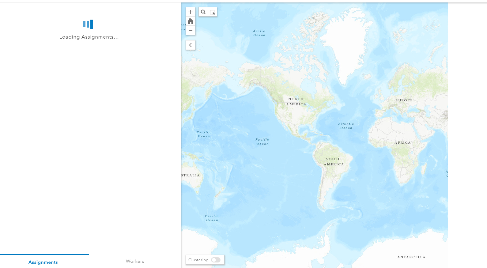

We have a couple of workforce projects that are opening, but not loading any assignments or workers. The data is still in ArcGIS Online, but the "loading" message never goes away. When the assignments finally show up, we can't assign anyone as it shows no workers as part of the project. We've opened up the app from both the administrator account and other dispatcher accounts. Is anyone else experiencing these issues? Only started happening within the last 2 hours.
