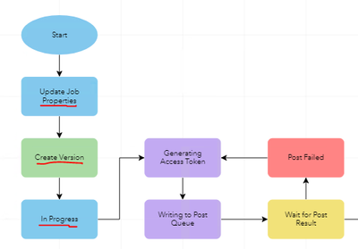

I'm deploying Workflow Manager onto a QA environment and encountering issues. I used some Esri-provided scripts to migrate my Workflow items in a dev environment to a QA environment and apart from a couple of manual updates to things like Job Name format, everything else seemed to copy over just fine.
On the QA environment, whenever a user creates a job through the Workflow Manager Pane in ArcGIS Pro, the Workflow Pane shows the job as Running, but it never gets out of this state. It's supposed to transition to an Open Pro Project Item to open a Map and point the version to the newly created version.
I can correct this by clicking on 'Switch active Workflow Item', the Cloud button in the bottom left of the panel, and re-entering the Workflow Item. It will have shown to properly enter the next step, opens the created version and it runs as normal. However, having to back out of the Workflow item and re-open it for every job isn't ideal for the users, as it should automatically transition to the next step (which is set to run Automatically when entered).

RichardOxales
@JFarmer Hi Jonathan,
Thanks for the response. Initially, the Create Version step presented the most problems as it was the starting point on many of my job diagrams. I'm not sure why updating permissions helped to fix its perpetual running state but it noticeably ran better and I just rolled with it after spending a day working through it. Create Version wasn't the only step that was hanging for me. I attached an image showing one of my job diagrams and highlighted the steps which sometimes don't properly start. These are using the Step templates like Update Job Properties and Open Pro Project Items (opens a map in Pro).
The users for WFM will be working primarily in Pro but the job statuses do update properly on the WFM web application.
From your answer, it sounds like my best course of action is to make certain steps manual instead of automatic? Virtually all of my steps in my job diagrams are automatic at the moment.

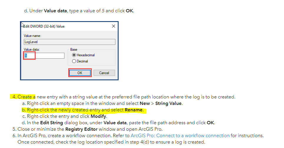

RichardOxales
@JFarmer I'm looking at the link to set up logging for WFM in Pro, but at Step 4, it doesn't mention what to rename the string entry to for the log file location. What should it be renamed to?
JFarmer
@RichardOxales
Hmm, you're right. Thanks for mentioning it, I'll make sure the right people know so we can get that fixed. You should name it LogsPath. Should look like my entry attached when you're done.
