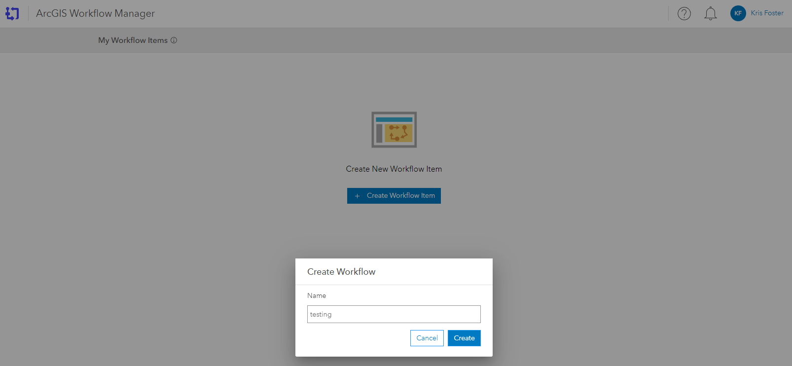

I'm trying to stand up a development machine with Enterprise Builder and Workflow manager installed.  I've got everything installed and a domain certificate in place and all appears to be working and I'm not receiving any certificate errors when opening portal / server / workflow manager URLs.  But when I try to create a new workflow item I receive the following
Reviewing the ArcGIS Server logs, I see the following errors.  I have no idea how to resolve this issue.  Anyone know what causes this?
SEVERE Nov 21, 2023, 9:03:36 AM ! @83j0ah0o9 - Internal server error, for (POST) [/workflow/admin/createWorkflowItem?name=testing&token=APplxCQbMKWhcBGHyG7G86ZByMBTxYP6yXnsgWPyb3fSN9CIX2y8-kufo4JCReh8hLazjEj6ZnjzEbiLrVTuU3SWTH7hrN-JlR4BqXlHWp45M9bWWAx2prm25Aqyd6W1Vg2BEZibH6NaXH9Fs_1xOTa-siDlEthZhf4P9eFce-SLhTJO93ShjPqYcT_lBLMzXX4Azei52BsCsP-hJoW_fwr95ki1ye_1ArP9vt2GGe1SMC77y-OJI1pXsiUS7qPnqGwMEL8vewoG_hsc6cXtJQ..] -> play.api.UnexpectedException: Unexpected exception[ConnectException: No trust manager was able to validate this certificate chain: # of exceptions = 4] at play.api.http.HttpErrorHandlerExceptions$.throwableToUsefulException(HttpErrorHandler.scala:358) Caused by: java.net.ConnectException: No trust manager was able to validate this certificate chain: # of exceptions = 4 at play.shaded.ahc.org.asynchttpclient.netty.channel.NettyConnectListener.onFailure(NettyConnectListener.java:179) Caused by: javax.net.ssl.SSLHandshakeException: No trust manager was able to validate this certificate chain: # of exceptions = 4 at java.base/sun.security.ssl.Alert.createSSLException(Unknown Source) Caused by: com.typesafe.sslconfig.ssl.CompositeCertificateException: No trust manager was able to validate this certificate chain: # of exceptions = 4 at com.typesafe.sslconfig.ssl.CompositeX509TrustManager.checkServerTrusted(CompositeX509TrustManager.scala:89) WorkflowManager
WARNING Nov 21, 2023, 9:03:36 AM Exception thrown during asynchronous load java.net.ConnectException: No trust manager was able to validate this certificate chain: # of exceptions = 4 at play.shaded.ahc.org.asynchttpclient.netty.channel.NettyConnectListener.onFailure(NettyConnectListener.java:179) Caused by: javax.net.ssl.SSLHandshakeException: No trust manager was able to validate this certificate chain: # of exceptions = 4 at java.base/sun.security.ssl.Alert.createSSLException(Unknown Source) Caused by: com.typesafe.sslconfig.ssl.CompositeCertificateException: No trust manager was able to validate this certificate chain: # of exceptions = 4 at com.typesafe.sslconfig.ssl.CompositeX509TrustManager.checkServerTrusted(CompositeX509TrustManager.scala:89) WorkflowManager
SEVERE Nov 21, 2023, 9:03:16 AM ! @83j0afobd - Internal server error, for (GET) [/workflow/checkStatus?token=APplxCQbMKWhcBGHyG7G86ZByMBTxYP6yXnsgWPyb3fSN9CIX2y8-kufo4JCReh8hLazjEj6ZnjzEbiLrVTuU3SWTH7hrN-JlR4BqXlHWp45M9bWWAx2prm25Aqyd6W1Vg2BEZibH6NaXH9Fs_1xOTa-siDlEthZhf4P9eFce-SLhTJO93ShjPqYcT_lBLMzXX4Azei52BsCsP-hJoW_fwr95ki1ye_1ArP9vt2GGe1SMC77y-OJI1pXsiUS7qPnqGwMEL8vewoG_hsc6cXtJQ..] -> play.api.UnexpectedException: Unexpected exception[ConnectException: No trust manager was able to validate this certificate chain: # of exceptions = 4] at play.api.http.HttpErrorHandlerExceptions$.throwableToUsefulException(HttpErrorHandler.scala:358) Caused by: java.net.ConnectException: No trust manager was able to validate this certificate chain: # of exceptions = 4 at play.shaded.ahc.org.asynchttpclient.netty.channel.NettyConnectListener.onFailure(NettyConnectListener.java:179) Caused by: javax.net.ssl.SSLHandshakeException: No trust manager was able to validate this certificate chain: # of exceptions = 4 at java.base/sun.security.ssl.Alert.createSSLException(Unknown Source) Caused by: com.typesafe.sslconfig.ssl.CompositeCertificateException: No trust manager was able to validate this certificate chain: # of exceptions = 4 at com.typesafe.sslconfig.ssl.CompositeX509TrustManager.checkServerTrusted(CompositeX509TrustManager.scala:89) WorkflowManager
WARNING Nov 21, 2023, 9:03:16 AM Exception thrown during asynchronous load java.net.ConnectException: No trust manager was able to validate this certificate chain: # of exceptions = 4 at play.shaded.ahc.org.asynchttpclient.netty.channel.NettyConnectListener.onFailure(NettyConnectListener.java:179) Caused by: javax.net.ssl.SSLHandshakeException: No trust manager was able to validate this certificate chain: # of exceptions = 4 at java.base/sun.security.ssl.Alert.createSSLException(Unknown Source) Caused by: com.typesafe.sslconfig.ssl.CompositeCertificateException: No trust manager was able to validate this certificate chain: # of exceptions = 4 at com.typesafe.sslconfig.ssl.CompositeX509TrustManager.checkServerTrusted(CompositeX509TrustManager.scala:89) WorkflowManager
KrisFoster1
After working with customer support, they let me know that the certificates have to be assigned in ArcGIS Server, and Portal admin URLs.  I had assigned the certificate to the ArcGIS Server admin URL (https://kfoster.kf.udc/server/admin/machines/KFOSTER.KF.UDC) but I also had to import and assign the certificate to the portal admin URL (https://kfoster.kf.udc/portal/portaladmin/security/sslCertificates)
Once the certificate was imported and assigned to portal as well, the workflow was created successfully with no more errors.
