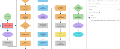

I am trying to use the Define Location Step after a Survey123 Step. I have tried using a survey with a geoshape question (name=location) with method=vertex as the body::esri:style and then with a geopoint question (field name = location)

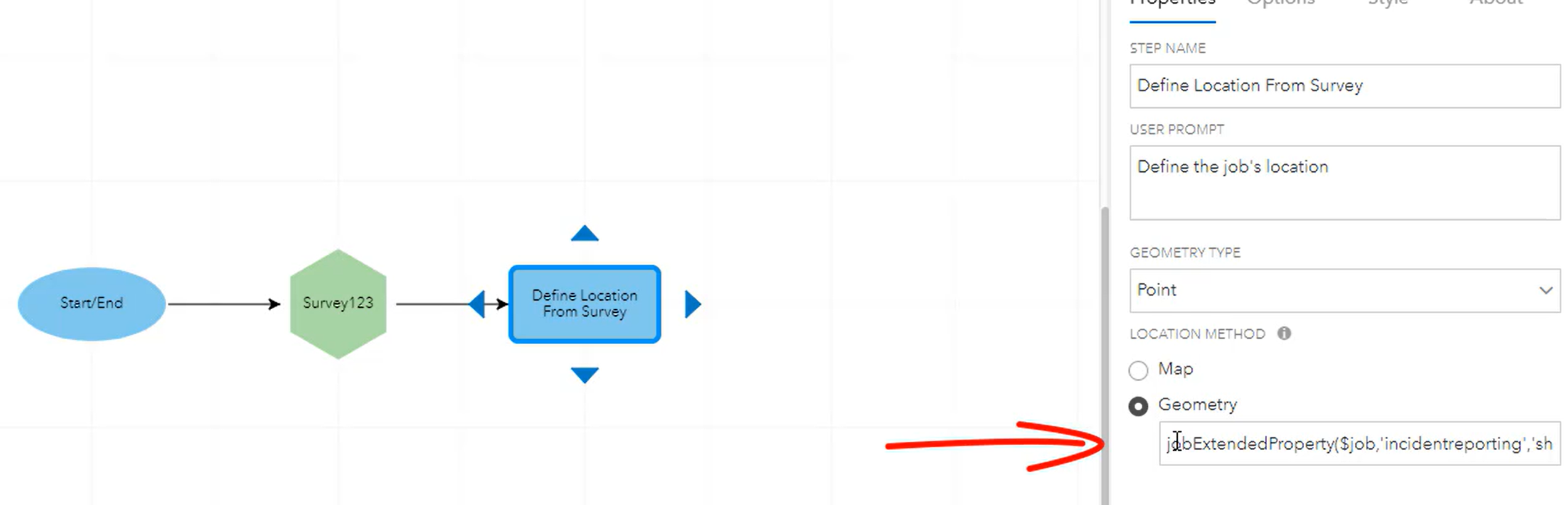

In the Designing Advanced Workflow video of the Workflow Manager learning plan, @JFarmer did this exact thing with a point question using the following in the Geometry location method:
jobExtendedProperty($job, 'incidentreporting', 'shape')

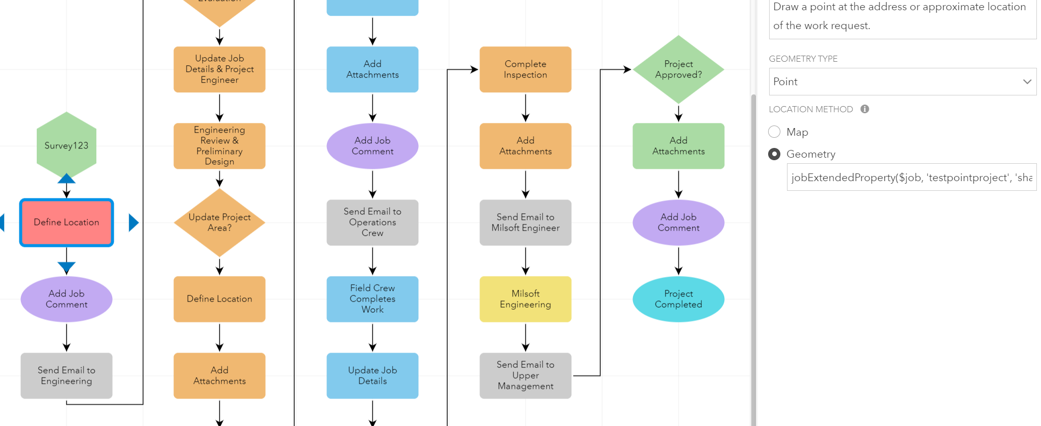

I am trying to do the same with the following:
jobExtendedProperty($job, 'testpointproject', 'shape') with 'testpointproject' being the name of the survey added. Is 'shape' the name of the geopoint/geoshape question, or is that pulling from the shape geometry of the feature layer? Either way, I keep getting an error "Failed to save location" when the Define Location Step runs.
Am I missing something with the Arcade expression?

Your expression looks fine so that leads me to think it's not that. Have you added the Survey123 feature layer as an extended properties table in your job template? The expression relies on that table existing.
As for shape, that's the geometry field from the feature service. It doesn't need to be the question name.

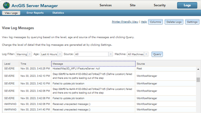

I'm also currently having the same issue. I've enabled the https://survey123.arcgis.com in the Allowed origins in the portal setting. However in the server admin, the setting for the allowed origins is already wildcard(*), so i don't think adding the link to the setting would rectify the issue.
In the server log, I got below information.
Appreciate if you guys can let me know if there is any other possible configuration that need to be updated to rectify the issue.
Thanks.
Regards.
JFarmer
@NurFarahHannanAhmad
I notice some unexpected message errors in the logs, that generally means there is more information at the Verbose or Debug level. I'd set the logs to Debug, try again, and see if there is some helpful information there to troubleshoot with.

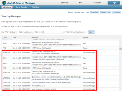

Hi @JFarmer ,
Thanks for the response. I tested the workflow and select the debug for the log and got below result. I tried to search for more info based on the error message, however there is not much info available. Do you have any suggestion on this?
Thanks.
JFarmer
@NurFarahHannanAhmad You would be looking for an error (none of those messages are errors or issues to be concerned about).
The easiest way to do this is to try to make sure no one else is using the server, get to the point where you are ready to reproduce the issue (like right before), delete all the server logs, reproduce the issue, and immediately query the logs. At that point, it may take some digging to find an issue. Tech Support could be a good help here to assist with that part as I know there are a lot of messages to sort through at the debug level.
If the issue is running the Define Location step, then you can search for messages around starting that step (you'll need to know the step ID which you can get on the diagram for that workflow). Then follow the messages from there to see if and what error(s) are logged.
