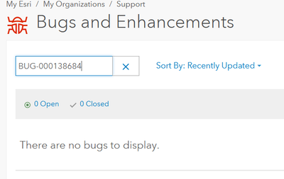

@Dan Are you sure you got the bug number right? I tried entering the bug in by cutting and pasting, and got "nothing found." Just to be certain I tried again in Firefox. Is it filtered on my account or hidden from public access?
I'm hoping for help on how to upgrade 3.28 to 3.35 and that the bug report would include information on that process.

Dan
Yup, copy and pasted.   When I clicked your link, my browser went right to the page.

They are filtering it and only exposing the bug to you. I reserve comment on this policy. At least they could issue a more transparent error message. Like one that says "you don't have access to that".
Is there any actionable information in there like maybe a link to something everyone can read or maybe that you can paste in here? Or is it just "you should upgrade to 3.31 or higher and you deal with it".
Dan
Ah.  I can see keeping cases private, but a bug is a bug, and everyone interested should be able to track it.  Anyway . . . No, nothing more.  Please see attached image.
