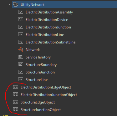

sjet1010
I have everything loaded, but I still get that error. Why is that?
