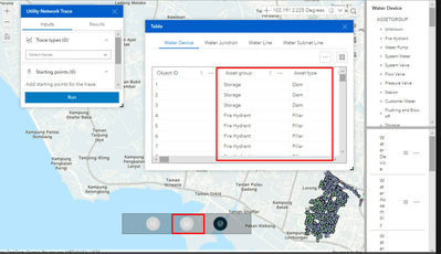

Hi everyone,
we encounter problem when we run the tracing, the result of the selected features in the table only show the domain code not the description.
but in default table it show the domain description.
What should we do. Thank you.

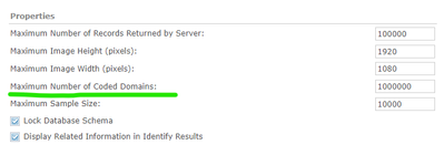

@NadiaAlami - Increasing the Coded Domains value on the service page should fix it. We have it set at a 1000000.
If that doesn't work then there was solution to increase the javaheapsize.
https://community.esri.com/t5/arcgis-utility-network-questions/domain-names-not-displaying-via-in-fe...
Hope that helps 🙂
