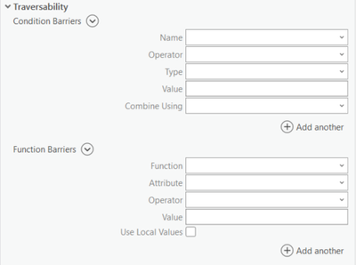

@rohanrajan_hms - Can you check the trace configuration and make sure there is nothing in the traversability options that might be stopping the trace?
