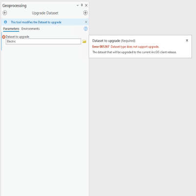

hi @MikeMillerGIS
I get this error when I try to run the Upgrade Dataset tool. my current utility network version 6
What needs to be done to upgrade to version 7?
MikeMillerGIS
Esri Frequent Contributor
Whats the full path you entered?
JohnGoat
i am working for file geodatabase
D:\work\UN\ArcGIS_Pro_3_3\UtilityNetwork.gdb\Electric
MikeMillerGIS
That is the FeatureDataset, not the Utility Network.
JohnGoat
Since the tool name is dataset upgrade, I showed the dataset 😞
Thank you
MikeMillerGIS
Technically, all classes are datasets.  Glad it is working now
