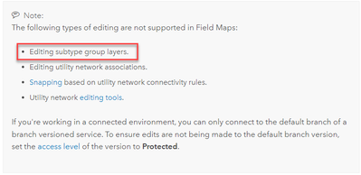

Attached and linked is what I have found so far...
On subtype group layers being the preferred approach: Understanding the Differences Between Utility Network Maps (esri.com)
Limitations of that: Subtype group layers and tables—ArcGIS Pro | Documentation

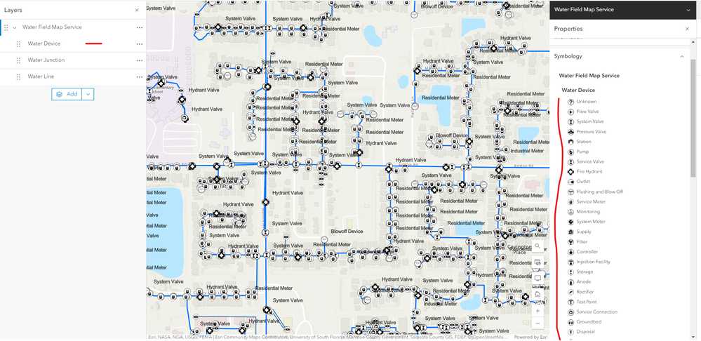

rlyding
@maiam I see your attached image you found my response in this thread. https://community.esri.com/t5/arcgis-utility-network-questions/publish-utility-network-subtype-displ...
To get domains to work at subtype level you will need to publish the UN symbolized by assetgroup (subtype).
This may also help. https://community.esri.com/t5/arcgis-utility-network-blog/best-practices-for-working-with-utility-ne...
Hopefully this will change in the future, but for now I think we are limited to publishing by assetgroup. I currently have valve collection setup with UN and Field Maps if you have a any specific questions.

Unfortunately I think the answer to your questions is within the limitations list in this documentation page: https://doc.arcgis.com/en/field-maps/ios/use-maps/utility-network.htm#ESRI_SECTION1_D9E9DD1BAA784C79...
maiam
Hi @GlenShepherd , thanks for the reply. I see this limitation with subtype group layers in field maps. I am curious if there is different way I can publish to have it editable in field maps and recognize domains that have been applied to certain subtypes? The two ways I have tried have not been successful.

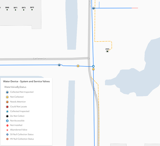

Here is how my UN valve collection is currently symbolized. The feature service was published up symbolized by asset group. I then set custom symbology arcade expressions and def query on the web map. If you have anymore questions let me know.

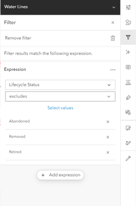

@AmberY Sure, here is an example on how to set it up in a web map.
Select your layer in the web map then on the right you can add in a definition query by clicking in the Filter icon.

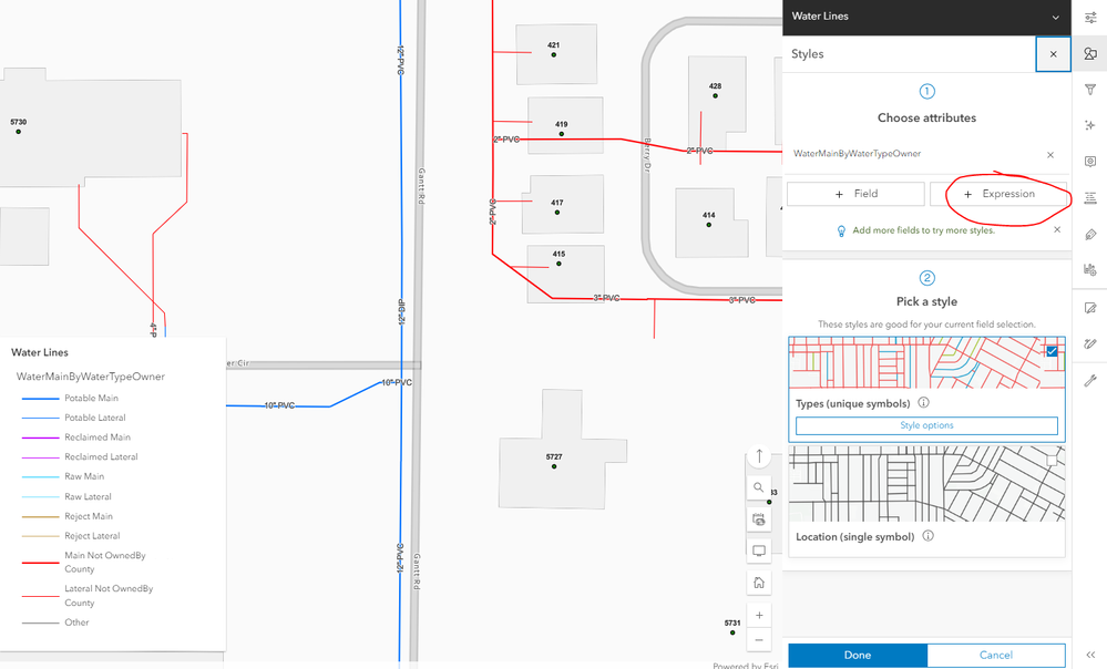

To setup custom arcade symbology you select the layer style icon on the right and then + Expression here is example arcade for Water Lines classified by ownership and water type. For the statements you can use either a if statement or when statement in this case I used a when statement. The values returned are what your symbol classes will be.
Here is the arcade I used.
var ag = $feature.ASSETGROUP
var wt = $feature.designtype
var owner = $feature.ownedby
When(ag == 1 && owner != 1, "Main Not OwnedBy County", ag == 2 && owner != 1, "Lateral Not OwnedBy County", wt == 1 && ag == 1,
"Potable Main", wt == 1 && ag == 2, "Potable Lateral", wt == 7 && ag == 1, "Reclaimed Main", wt == 7 && ag == 2, "Reclaimed Lateral", wt == 4 && ag == 1,
"Raw Main", wt == 4 && ag == 2, "Raw Lateral", wt == 8 && ag == 1, "Reject Main", wt == 8 && ag == 2, "Reject Lateral", null)
 Here are some additional resources.
https://support.esri.com/en-us/knowledge-base/how-to-assign-colored-symbols-to-attributes-using-arca...
https://pro.arcgis.com/en/pro-app/latest/help/mapping/layer-properties/set-custom-expressions-for-sy...
You can also use arcade expressions for labels.
