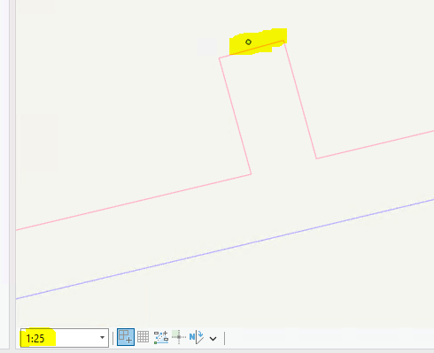

I have noticed one error/ bug.
In my data, in some of the places, the points are not exactly on top of the line.  The data are migrated to UN with the help of FME. The data is correct in geometric network. However,  in ArcGIS pro, it seems like the point is not on top of the line, when it is really zoomed in.
When I perform a Connected Trace from this line, the point is not selected. Hence, it is a problem. It looks like the data is not correctly configured, but this was not a problem in old version of ArcGIS PRO.
This does not give any dirty Areas.
Has anyone else encountered the similar Problem? Is it a bug from this PRO version?
It would be great if I could get an idea regarding this issue.
Thank you in advance
-Shlesha

If you look at the same FGDB using ArcGIS Pro 2.9.5 does the data appear correct if you add the data to a new map in ArcGIS Pro? Upgrading your ArcGIS Pro shouldn't affect the data that is stored in the database.
gis_KIWI4
MVP Regular Contributor
@Acharya - I would suggest revisiting the FME workbench and making sure no transformers are changing the the geometry of the points in any way i.e the precision of co-ordinates is not changing.
ArcPro versions will not change the location of the point.
