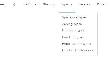

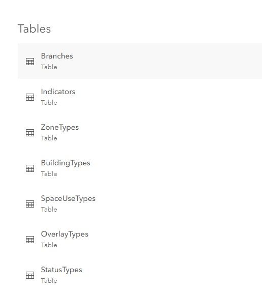

When creating a new Urban Model, where are the land use tables and feature class data stored in AGOL?
For example, Space use types and Zoning types (first screenshot) both have corresponding hosted tables within the hosted feature layer (second screenshot) that get created whenever you create a new Urban Model. This is nice because it allows you to access and edit this data outside of the Urban UI. This seems to be the case for all of these features/tables except for the Land use types table and feature service. Where do these things live?
^^^The tables listed here in the Urban UI are the same tables you find in the feature service table below except for land use types^^^The tables listed here in the Urban UI are the same tables you find in the feature service table below except for land use types
^^^The tables listed here in the AGOL feature service are the same as the ones listed in the Urban UI except "Land use types" is not there. where is it?^^^The tables listed here in the AGOL feature service are the same as the ones listed in the Urban UI except "Land use types" is not there. where is it?

Hi @AlexRudowski
Both - the land use and zoning types live in the table "ZoneTypes". The different types can be distinguished by the "PlanningMethod" field ("zoning" vs. "land-use").

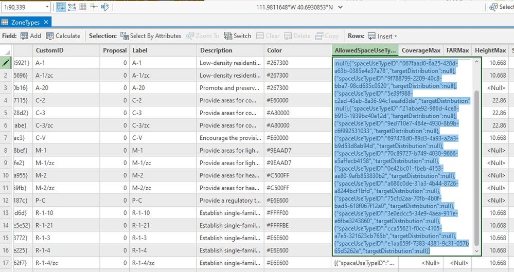

I'll take a look at getting started with the Urban API. Many of our zones have very similar space use types to at least one other zone. Instead of going through each zoning type in Urban to add the same 50 or so allowed space use types, I've been grabbing the URL for the hosted feature service, adding it to Pro, and then copy/pasting the space use type IDs (screenshot)  from one relevant field to another. I guess I can use the API to do this?

The A-1 and A-1/zc zones have almost all the same allowed uses types. Instead of adding all the same allowed uses manually in Urban, I just copy/paste the IDs from one record to another in Pro.The A-1 and A-1/zc zones have almost all the same allowed uses types. Instead of adding all the same allowed uses manually in Urban, I just copy/paste the IDs from one record to another in Pro.

Yes, you could update your ZoneTypes using the Urban API using the updateZoneTypes mutation. In more detail, you need to provide arrays of the spaceUseTypeId in the AllowedSpaceUseTypes type in the ZoneType attributes.
You can do it (or simply try it out) directly in the Graph QL playground. See Discover the Playground section in the Urban API docs to learn about the GraphQL Playground. You can also write a short Python script that will send the relevant mutations to the API and update your zones types in the loop. Please see the sample code page for examples.
