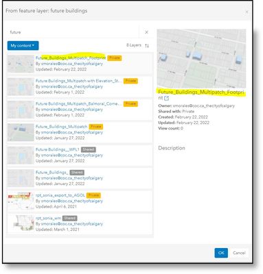

I am having trouble loading Future buildings. I added the Projects as a Feature Layer (polygon).
What type of feature layer should I use to add the Future Buildings? I tried polygon feature layer and a scene and none of them work.  Any ideas?

For future buildings I am importing a Multipatch  footprint scene.

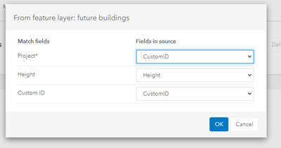

When I try to match Project with Event Name or Event. I get an error (See below)
I am only able to connect Project with CustomID and get an error, see below.
What exactly do you mean by a "Multipatch footprint scene"? Are you trying to import the footprints from the associated feature layer of a 3D Object Scene layer? Does your future buildings layer only contain the building footprints that you'd like to import to your Urban Model or does it also contain other features?

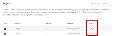

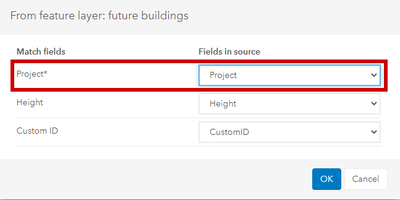

The screen with the validation errors is displayed if there are footprints in the future buildings layer that cannot be matched to a project.
A potential reason is that the values in the "Project" field of the future buildings layer don't match the projects' "Join ID".
Please ensure that the values stored in what you configure as the "Project" field when importing the future building footprints are matching the "Join ID" values of your projects.
