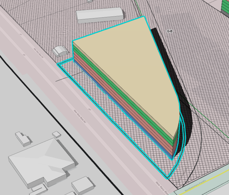

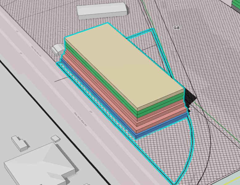

I have upper tier setbacks set in one of my zoning types. These setbacks are enforced when I have the building type footprint shape set to "rectangle," but it is not enforced when the shape is set to "auto" or "parcel." Is this a bug, or a known limitation to the application?

From the screenshots it is hard to tell if the result is expected or not. I'd like to point out the following:
  • Generated buildings depend on all zoning parameters. There can be situations where tiers are not effective because the building is already restricted by another regulation (e.g. coverage).
  • Generated buildings depend on the building type and its parts. Podiums are built "as wide as possible", towers are built "as high as possible". Also in this case, tiers might not be effective.
  • Setbacks are always measured from the edge of a parcel. What setbacks are effective also depends on the orientation of the parcel edge. A way to visually check if  the setbacks are correct is by enabling zoning envelopes. To do this, first click on the hamburger menu and enable zoning envelopes in the list of layers. Second, go to "development" mode, click on a parcel and, in the right side panel, scroll all the way down to check "display zoning envelopes".
Based on my general remarks, would it be possible to give me more information on your issue? E.g.:
  • Do you have other zoning regulations set that might limit the building (e.g. coverage or FAR)?
  • Could you provide a description/screenshot of your building type?
  • Could you enable zoning envelopes (as described above) and provide a screenshot?
  • Could you provide a screenshot of your setback settings?
Thank you!
