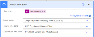

Good morning.  I have a step in my flow that converts the time zone.
addSeconds('1970-1-1', Div(triggerBody()?['feature']?['attributes']?['Effective'],1000))

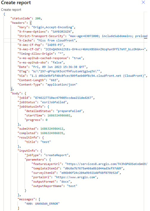

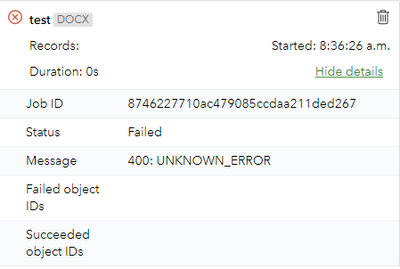

Hi @IsmaelChivite ,  I'm trying to generate a report using the Power Automate webhook and I am getting an error on the Survey123 end.  The trigger is received by Survey123 but generate report job fails.
On the power automate side of things, this is the error:
Has anyone seen this error before? Any idea where I might be going wrong?

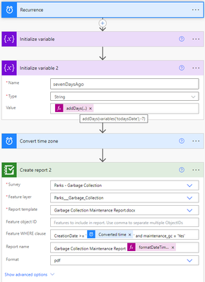

In the What's new in ArcGIS Survey123 (June 2023) blog Ismael posted, it mentions there's now a WHERE clause for summary reports, I know I saw a bunch of people asking so I'm going to post my example!
I set mine with a recurrence to happen once a week, created a variable for today's date, then set a variable for seven days ago, using the formula addDays(variables('todaysDate'),-7). Converted the time to my time zone and then built a where clause in the report for items newer than 7 days ago using that dynamic content (and checking if maintenance is needed).
The steps after are the same as discussed for attaching it to an email. Sean McGinnis over in the Power Automate section of the Esri Community helped me with this!

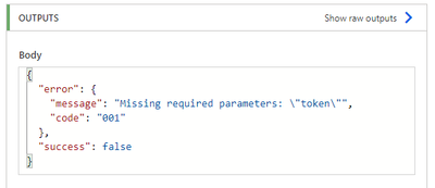

Hi @IsmaelChivite is there a limitation on the Create Report action where the token will timeout on a given interval? I've noticed a few times in the past month where my flows have failed and I have gotten
I remember this being an issue with the ArcGIS Connector itself, but never with the Survey123 connector, I've had it happen within the last 24 hours and on May 24/25th, and if I go to the Connections and re-sign in to the Survey123 connector the flow then works perfectly fine again.
Eimear
Hi @IsmaelChivite, thanks for the info. I have a few WorkFlows working nicely with Survey123. But I am running into the same issue as @RobertAnderson3. The re-sign in workaround works for me too. But it would be great to know if there is a cleaner solve?
RobertAnderson3
MVP Regular Contributor
It is a 14 day timeout currently, it was mentioned here: https://community.esri.com/t5/arcgis-survey123-videos/survey123-tricks-of-the-trade-live-automate/m-... but not in any actual documentation I've seen.
The solve is between Esri and Microsoft sorting out the struggle.
