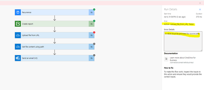

KhemAryal
I am not able to create flow. I keep getting the error
IsmaelChivite
Esri Notable Contributor
Hi @KhemAryal   Check the output of the Create Report tool. I bet the problem is there. For some reason, the PDF could not be created and then the next module fails because a required input for it is empty.
Looking at the Create Report parameters (the WHERE clause in particular) is important to diagnose the problem.  I am guessing that the WHERE clause you included is not returning records. No records, no PDF... nothing to upload.
KhemAryal
@IsmaelChivite You are right. Report was not created in the output as I did not put correct syntax at Where clause.
what would be the 'Where' clause syntax if I just want to see the records for the last month. I can do for last 30 days but not all the months are 30 days. There should be easy way to do it but I kept failing. any suggestion?

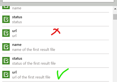

SayedWali
In Create report, make sure you take the url with the text (url of the first result file):
then follow other steps.

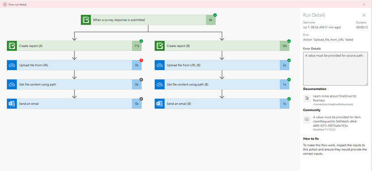

I'm working on a scenario:
A S123 form is submitted.  If ${Municipality} = 'x1' follow FlowA (Use Report Template A, email to one group of people)
If ${Municipality} = 'x2' follow FlowB (Use Report Template B, email to a different group of people)
I have the flow set up and it actually works (see image) but - If the S123 report is not created because it is not for that municipality, then the rest of that branch fails (makes sense - there is no report).
The where clause says: Municipality = 'x1'
and then for the other create report it says: Municipality = 'x2'
Here's my question - is this ok?  Or is there a better solution?  Power Automate thinks it failed because there is no report to upload.  But I do not consider it to have failed because it created the correct report and emailed the correct content.  Should I leave this alone or will this get me in trouble later down the road?
Appreciate any advice!
IsmaelChivite
@DevinCarlson  I think a 'condition' should help here. Check: https://learn.microsoft.com/en-us/power-automate/add-condition
DevinCarlson
Great!  Thank you - I will try to incorporate this.
