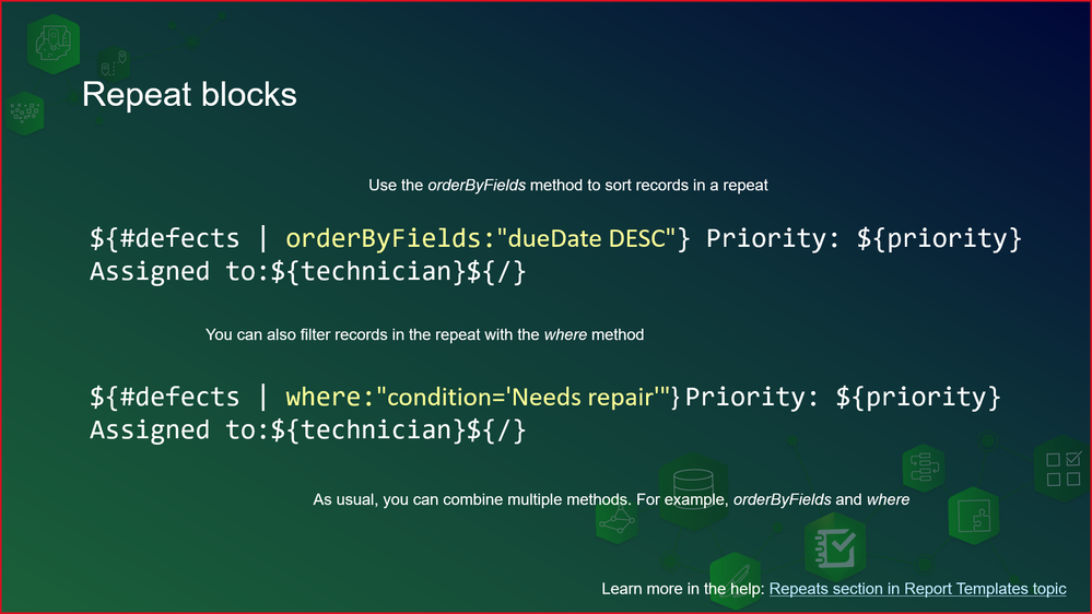

Could we filter or limit the repeats?
Yes. You will want to use the where method for that. Below is an example:
Can I limit the repeat records that are shown to the last 30 days?
Yes, you will want to use the where method. Here is an example
${#inspections | where: " inspection_date BETWEEN CURRENT_TIMESTAMP - 30 AND CURRENT_TIMESTAMP" | orderByFields: "inspection_date DESC"} ... ${/}

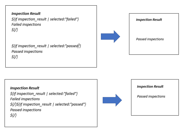

Thanks so much for this, @IsmaelChivite ! A follow up to the dynamic visibility question answered above: is it possible to hide a section from view based on the survey response? I.e. switching the syntax logic from showing text if "yes" to hiding text if "no". If so, what would that syntax be?
IsmaelChivite
Esri Notable Contributor
@EleanorSwensson I am not sure I follow the question. The 'if' operator lets you hide and show sections of your report. Check out this help topic for details: https://doc.arcgis.com/en/survey123/browser/analyze-results/featurereporttemplates.htm#ESRI_SECTION1...
MD7
@IsmaelChivite is it possible to do something like if - else condition?
For example, $if{inspection_result | selected: 'passed'} Passed Inspection else failed Inspection.
i.e if the condition is true display the text 'Passed inspection' else display the text 'Failed Inspection'
ChrisBoland
If you're using a select_one type question to say whether the inspection passed or failed, could you use the "checked" method? For example:
${inspection_result | checked:"passed"} Passed Inspection
This would result in a filled checkbox if the inspection_result select_one question's answer was "passed," otherwise, it would be an empty checkbox.
