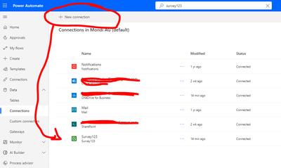

RyanB1
Does this work with Portal or only AGOL at this stage
Paulvan_Heerden1
Hi there
I assume both, as you specify the data connector that is uses. Maybe play around and see if you can get it to connect to your Portal. Add a new Survey123 data connection as you can see below. You can then configure it to your Portal...... I think! 😁 Maybe give it a try.
RyanB1
Hi Paulvan
When i click on the new connection it auto takes you to the agol login and doesnt let you specify the portal url. Is there a way to redirect this?
Paulvan_Heerden1
Unfortunately I am not sure. I just went to go have a look myself, and I am not sure how you would do it (if you even can).
@IsmaelChivite ?

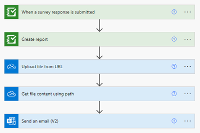

I don't get the URL options under "Upload File from URL", stopping me in my tracks. Does this flow require a Premium PowerAutomate license?
Paulvan_Heerden1
What are you trying to do with this flow? If you are trying to create a S123 report and email it, then you don't have the correct actions. Have a look at some of my posts above to see what I did

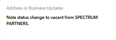

@IsmaelChivite Thanks so much for this! I created two flows with this logic and they are working great! I am running into a snag on one flow though. I want to use a conditional statement that when a field in my fire inspections survey is filled out (mentioning that there is an issue with the address), an email gets sent to the GIS department and E911 Department to solve the addressing issue.

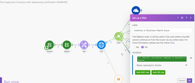

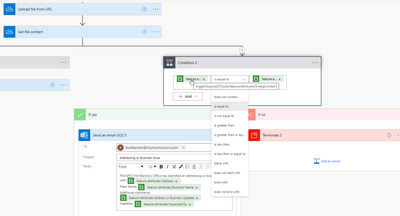

 In Make I can set up a conditional statement where if this field exists, then it will send the email to the aforementioned departments. How do I do that in Power Automate?
Make:
 Power Automate:

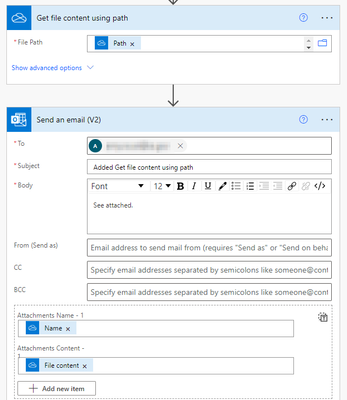

Like others in the comments on this post, I wanted to email my report after it was created. I had a hard time getting the right settings for the Get file content using path and Send an email (V2) steps, so I'm sharing a screenshot of those two steps in the hopes that it will save others some time!
For reference, here is my entire flow (I didn't add a step to delete the PDF because I like having a backup copy.)
