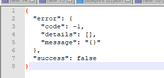

Interestingly, when I look at the webform that gets created successfully during the publishing process, the content of the .webform file is as follows:
"error": {
"code": -1,
"details": [],
"message": "Error: [object Object]"
"success": false
This issue appeared immediately after the September 16th update, prior to any efforts to republish or change the form.

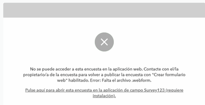

When we try to access from web access, the error show is this:
This survey cannot be accessed in the web app. Please contact the survey owner to republish the survey with 'Create web form' enabled. Error: Missing .webform file.
Press here to try to open this survey in Survey123 field app (installation required).

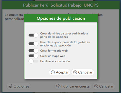

When the survey is published again, we enable to create webform option:
Webform file content is:
It's very important for our project, correct the error as soon as possible.
