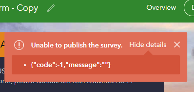

RainbowUnicorn
Just saved a copy and tried to republish.  Got this error, which is the first one I got during the first iteration of attempting to publish it.  Thinking I might open a support ticket as this isn't the first time Survey123 in the browser hasn't "behaved" in my environment.
MJBiazar
@RainbowUnicorn I'm sorry to hear that you are experiencing a different issue while trying to publish a copy of your survey (you may find this post helpful). Whatever is causing this issue may be related to the issues you were experiencing with your original survey. I think at this point it's best for you to create a case with Esri Technical Support to take a closer look at your issue and continue troubleshooting.
RainbowUnicorn
@MJBiazar - Just a quick update...I quit trying to edit the form on my work computer.  I went and started working on it on my personal computer (which is unfortunately common practice due to frequent issues with ESRI application functionality on our work network) and surprise, surprise!  No problems, everything worked just fine.
Thanks for your attention/assistance, but I think we can safely assume the issue lives in IT.
MJBiazar
@RainbowUnicorn Fantastic! I'm glad that you are not experiencing the issue on your personal computer. I agree with your assessment as well. The issue seems to be specific to your work environment (the machine, network, etc.)
