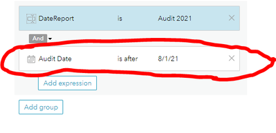

This is not working for me even in the Beta website. I'm no longer getting the error when trying to generate the report which is great...but the report output doesn't seem to apply the filter appropriately. Here is my applied filter and the resulting output in the report where it is still showing all audit records despite my filter (I only want to see audit info for 2021):
Travis_GIS
FYI, the Audit Date filter is within the repeat, the DateReport filter is not. Also, the filter works and is applied in the attribute table, however, when I run a report, the filter is not applied.
Ruth_JiatengXu
Hi @Travis_GIS
This might be an known limitation, by default, the report will show the filtered records in the parent table, and all the related records of them in the related tables.
You could use a where filter in your report template to filter the record in the related table, here is the syntax: ${#layername | where: } ... ${/}
Please let me know if this is not the case.
