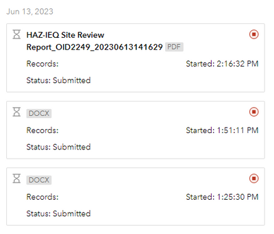

In case this is different from the ArcGISRequestError, I will make a separate post.

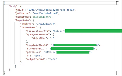

Presently, my reports are just timing out without an error message. This started ~3 hours ago. No reports are generating at this time (no error message).
(This is from Power Automate. The automation timed out after ~30 minutes)
BarbaraWebster1
Hi @abureaux,
This behavior is consistent with how the service disruption earlier today was impacting the report API. The disruption status has been set to resolved and we are seeing export functionality returned to normal on our end. Are you still seeing issues with exporting reports?

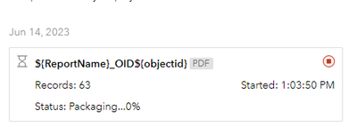

@BarbaraWebster1 We're still seeing some issues with report generation, particularly with getting stuck at the "Packaging" stage. This one has been going for 10+ minutes.

RobBlash
Hi Barbara,
  • No enterprise in play here, everything is AGOL HFS
  • exporting a small number of records seems to work, but 50+ records seems to trigger the problem
  • It's a bunch of surveys in my org that are having the issue
  • Yes, all surveys have been in use and working as expected since 2020. This issue first began Wednesday morning June 15th
