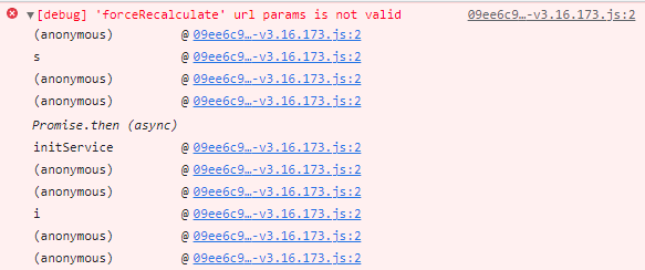

I am trying to open a survey in edit mode, and have a date/time field automatically update on an existing record. However, I still see the recalculate button in the web form and the old date is displayed. In Survey123 Connect, the [IssueDate] field is set to calculate to =now(). I've tired to recalculate other calculate fields and none of them will auto-calculate when the form is opened. Web form was published using the latest version of Survey123 Connect (3.16)
Here is my url with parameters:
https://survey123.arcgis.com/share/167df9fb24694a0da5c66b5bdeea1dac?mode=edit&globalId=70268755-16a8...
I believe I correctly followed the syntax from this blog post. I also noted that the following error is showing in the browser console:
mwartman_grey
Updated January 9, 2023. The url parameter ?forceRecalculate is now ?recalculate
