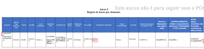

Good night, I noticed that there are more problems related to this one, I try to post it but it always generates the same error
how can you help me to solve this problem?

After a quick glance, I believe it's because you're trying to reference ${aa} inside of the repeat (in the report template), but in the xls form that question is not part of a repeat.
Looks like ${aa} is declared in row 36 and the repeat isn't created until row 56 of the XLS form.

hello the problem was in the type of name applied in the settings tab
the correct
form_title form_id
POQExecucao POQExecucao
the wrong
form_title form_id
POQ_Execução POQ_Execução
