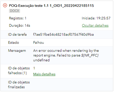

the data are all in conflict, I've tried everything, even some tips, but changing the name of the layer, the sending of new reports no longer works, which is not reliable to change the name of the layer... can someone help me help with a solution to this problem? the field is recognized, but when exporting the report it sends this error

hello the problem was in the type of name applied in the settings tab
the correct
form_title form_id
POQExecucao POQExecucao
the wrong
form_title form_id
POQ_Execução POQ_Execução

Hi, are you using a custom report template? If yes, have you tried going to Manage Templates and then creating a Sample Template? If the sample template works, then you could compare the sample to the custom one and maybe identify the problem. This technique has worked for me in the past.

Hello MatthewCarey, thank you very much for sharing your idea, I tried to follow your idea, but it doesn't work, the camo exists, it is present in the same way as the custom template, but it gives an error when creating the report.
