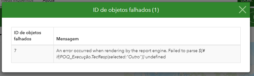

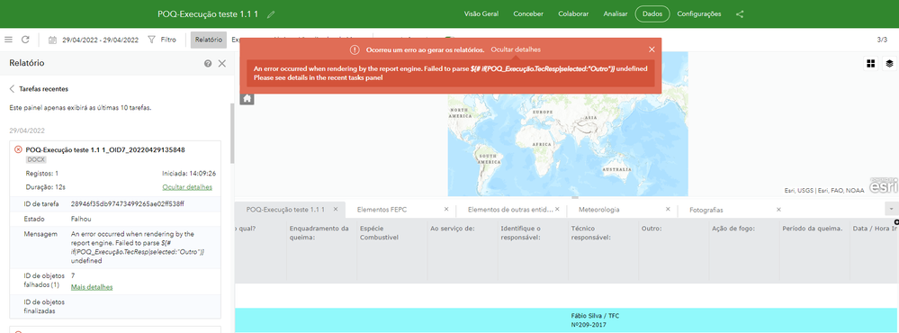

Good afternoon, this error is becoming a big problem, at the moment it is already found in more fields that were working before... I don't know what's going on with the survey123 data report
can anyone help me with this problem?
thanks

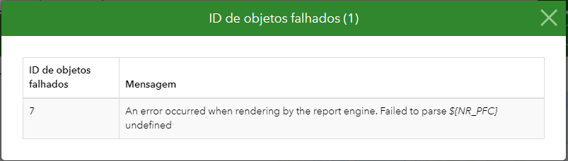

hello the problem was in the type of name applied in the settings tab
the correct
form_title form_id
POQExecucao POQExecucao
the wrong
form_title form_id
POQ_Execução POQ_Execução
