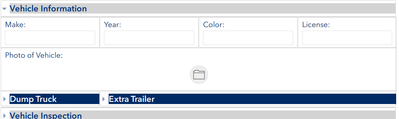

I need help with some grid questions regarding survey123. I'm trying to create a form (survey), with a 2 subgroups. I typed 'w4' into their appearances to try and get them to stretch to the entire form, but they just end up stacking up next to each other. Please advise.

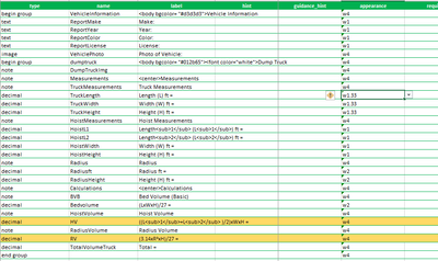

Can you share your XLSForm (xlsx file and any media folder files) so we can take a closer look?
With grid theme you need to ensure the w appearance is applied to all groups and questions inside those groups if you want to set different widths.

I did apply the w appearance to all. what im referring to is the dumptruck and extra trailer portions

I know the 1.33 don't work, but i assumed that it wouldn't be the cause of it anyway given that I edited them and it didn't change anything.AaronBrown3_1-1631555250358.png
