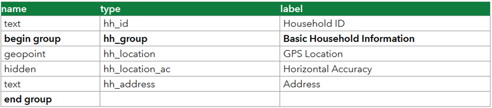

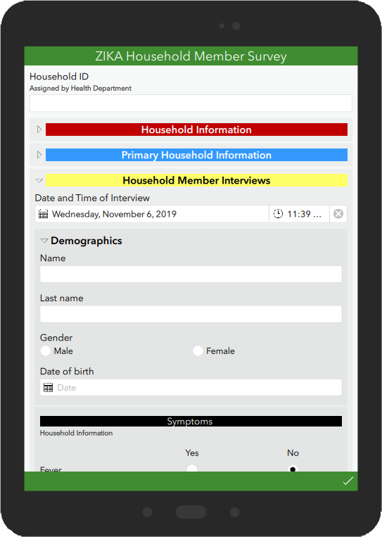

The font of group labels by default is a bit bigger and bolder than the labels of questions. This helps the group header stand out. Using HTML formatting within the label column of the begin group row, you can bring your own style to the group header. For example, you can center the label in the screen, change its color, and size.
In the example below, the group headers have been given different background colors to help users navigate more quickly between them. Note that the first two groups, in red and blue, are collapsed but users can choose to expand them.
The style your survey help topic shows the HTML tags you can use to format your labels. When setting colors, you can use either their HTML code name or their hexadecimal representation. At W3Schools you can use the handy color picker for HTML colors. All the properties described in the documentation are supported in the Survey123 field and web apps except for the background color, which is only supported in the field app.

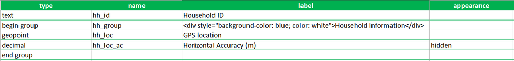

The next XLSForm sample shows the syntax for defining the background color of the group header.

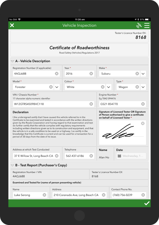

Even for smaller surveys, pages can be useful. In the example below we have a Special-Use application permit form.  I added a welcome image and text on the first page to create a cover for the form. Note that the first page does not expect any input from the user. It is just a welcome page, or cover page to the survey. Next, I organized the actual questions within my form into pages, giving each page a descriptive title at the top. As users move from page to page, a progress bar at the bottom shows how close they are to the end of the survey.
In the Survey123 field app, users can easily move through pages in the form one by one. Alternatively, a page menu lets users jump to any of the pages in the form with a simple selection. In the example shown below, the page menu helps the user jump from page 3 to 32 with just a couple of taps.

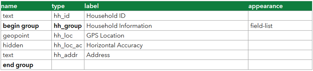

Once the style is set, add one group for every page you want and set the appearance of the group to field-list. For example
When working with the pages style, it is good practice to have all questions within a page. That is: make sure all your questions in the form are within an existing group with an appearance set to field-list. If you leave questions outside of a page, you will get erratic behavior across the web and field apps where a single question may appear on every page.

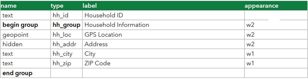

Once the grid style is set, all groups within your survey will contain questions using a four-column grid layout. You can change the number of columns in a grid by simply adding the w (as in width) property to the appearance column of your group. For example, w2 means two columns, w8 means eight columns.

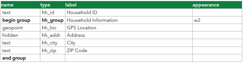

Unless specified otherwise, questions within a group will always take one column of the grid. In the example above, the GPS Location and Address will be placed side by side in one row, and the City and ZIP Code will complete a second row.
Using the w property for the individual questions within the group, you can choose how many columns you want each question to take. In the example below, I gave two columns (one full row, since the grid has two columns) to the GPS Location question, and another full row (two columns) to the address. I then arranged the City and ZIP Code questions side by side giving them a w1 appearance.
 When using a grid layout, questions outside of a group always take the full width of the screen. In the example above, the Household ID question is outside the group and as such, will take the full width.

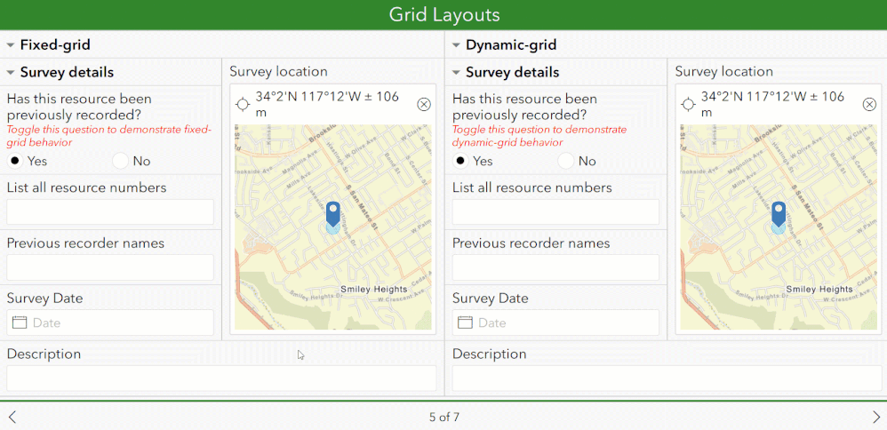

The difference between fixed-grid and dynamic-grid styles is how Survey123 questions are positioned within the grid. When using the dynamic-grid style, questions and groups may move around on the form in an attempt to make best use of the screen real estate.  The fixed-grid style is more predictable. A question will appear if its relevant/visibility conditions are met, otherwise a blank space will occupy that part of the form. No questions will move or stretch to fill available space.
Here is an example showing how the two different styles behave. On the left side, the fixed-grid style is used. Note how the positioning of questions never changes, just their visibility.  On the right side the dynamic-grid style is used. In this case, the Survey123 app attempts to optimize the positioning of the questions as they are hidden or shown.

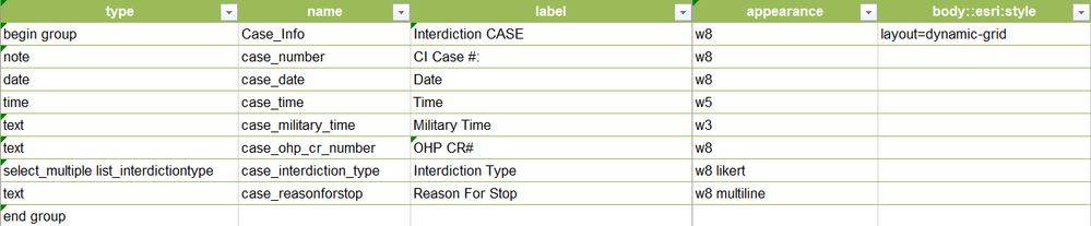

When you apply a grid style through the settings worksheet of your XLSForm, the style is applied to all groups within your XLSForm design.  You can however overwrite the style for a group using the layout property in the body::esri:style column.
In the example below, the grid style for the Case_Info group is overwritten using the body::esri:style column.

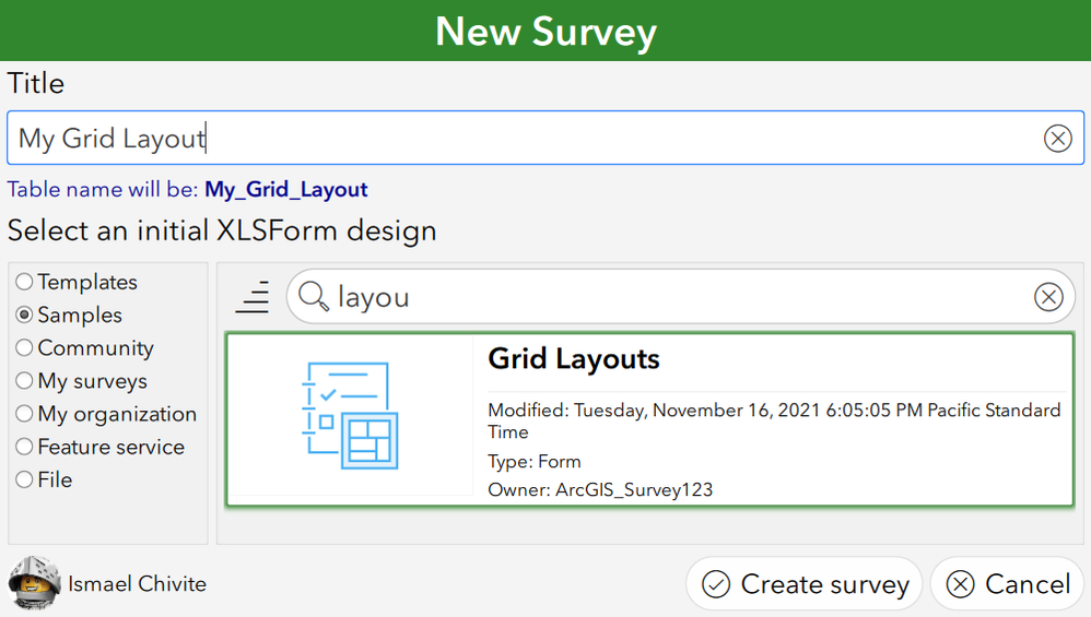

  • Survey123 Connect includes a handy XLSForm sample called Grid Layouts. It shows some advanced techniques, including arranging repeats and geopoint questions side by side, combining pages with grids, etc.
