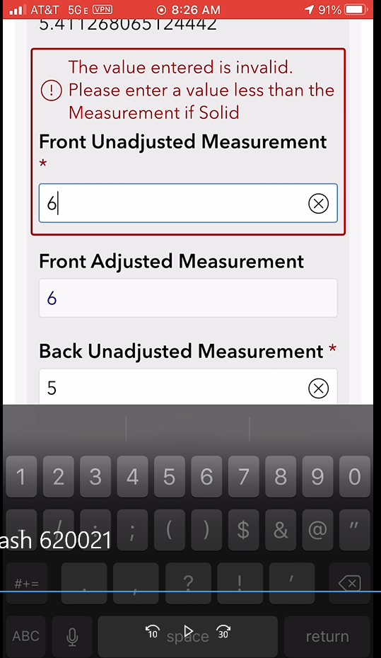

Sorry for some reasons i just saw your reply. it works fine until i press  the x at the end of the question to delete the answer (on iphone 8 version 14.7.1). When i hit that x to delete value. It just crashes with no error messages. What I have just done to make it work was to make the field above a string. This still does not really answer why I cannot hit the delete X at the end of the question after I reviewed the question on a decimal field (double). My best guess is that it does not know how to handle NULL values in calculations in a decimal field but again I tried a calculation to only calculate if the filed is not null and it still does not work...
if(string-length(${front_unadjusted_meas_0_1})>0, cos(${degreestoradians_0_1_test}) * ${front_unadjusted_meas_0_1}, 'None')
Attached below is my isolated question.
