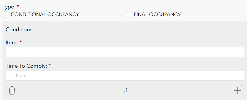

By default a repeat will display one blank record to be completed by the user with the ability to add and delete records:

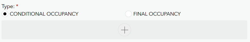

I would like to make the repeat relevant to a type (either conditional or final), if it is conditional, the repeat is relevant, if it is final, the repeat is not relevant.
When I add the relevancy, the repeat doesn't display a blank record, just a plus sign.
This behavior is not consistent with the default behavior.  If the repeat is relevant, then one would expect the user to be entering some information so I would like to show the first blank record, but I can't figure out how to do it.  Is there any way to get the behavior I want?

Just wanted to add to this.  If you notice, the questions in the repeat are required.  I wanted validation so that if a conditional type is chosen then the user is required to enter at least one condition.  The validation does not happen if the initial record in the repeat does not exist (ie. when just the plus sign is displaying).

When a question or repeat is not relevant, there is no value associated with it.  When it is shown, it displays a 'blank' value of 0 repeats.
JamieKelly1
Yes, that is what it is doing - showing 0 (zero) repeats.  Why does it do that when it becomes relevant?  The default behavior without relevancy is to show 1 repeat (still 'blank' value).  I tried setting a default value, that didn't do anything.  If I set 'repeat_count' to 1 then I will see a repeat, but they cannot be added then, the number of repeats is then fixed to only 1 repeat.  How about a setting for minimum repeat count?

I'm having the same issue. When a repeat has a "relevant" requirement that is fulfilled, it appears as  plus sign, rather than appearing as the question is formatted. Users are forced to click on the plus sign in order to see the questions within the repeat. This is highly problematic, since most users simply skip over the repeat without even realising it is there.
I have been forced to change the label for the repeat section to "PRESS THE BIG + SIGN BELOW BEFORE ANSWERING ANY OTHER QUESTIONS".

There is a beta feature now at version 3.10 for visible questions as opposed to relevant questions.  I have been playing around with it and it seems to work for my problem.  Maybe it will work for you as well.
In the survey sheet of the xlsx add a new column with body::esri:visible and then cut and paste the formula from the relevant column to the body::esri:visible column.
see a reference here about it https://community.esri.com/thread/257916-hidden-appearance-for-geopoint
quote from the reference: "Both of these new features currently work as expected in Connect and the field app with 3.10, however are not supported in the 3.10 web app. Once they are supported in the web app (currently scheduled for 3.11) then both features will be fully supported."
In my situation, I also had the questions in the repeat as required so they would still be flagged as needing to be completed when not visible so had to apply relevant to each question within the repeat.
