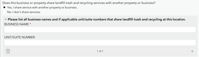

Has this been figured out? I would like for a group of repeated fields that show up if relevant (if yes is selected) to start with an blank iteration rather than just a plus sign.
Not this but
this.
Thanks!
