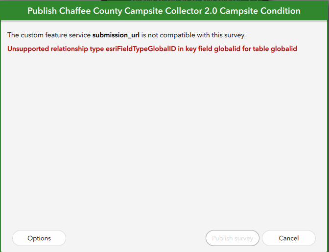

I am trying to publish a survey to a table and one existing feature layer.
I was having issues with trying to link to both a table and a feature layer but thanks to @DougBrowning I was able to address this issue by creating a repeat that points to the hosted feature layer.

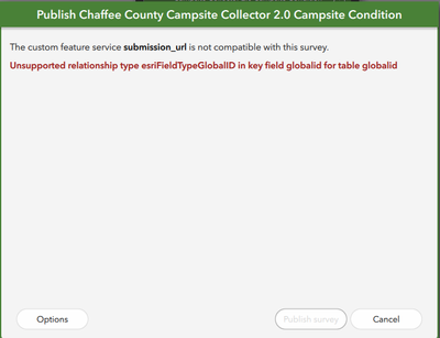

Now, I am having an issue where I am unable to publish due to this error:
I have read this thread:
https://community.esri.com/t5/arcgis-survey123-questions/unsupported-relationship-type-when-publishi...

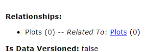

However, when I look at the table that the survey is pointing to the parentglobalid field is there:
Thanks for any help.

Looks like your relationship class is still not correct is my guess.  Can you post some screen shots of it.  Either in Pro or from the rest service.  Not sure why the message says globalid several times (table globalis?).
Weird post us some shots and maybe the form.

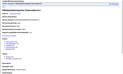

Here is the rest for the feature layer:

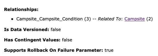

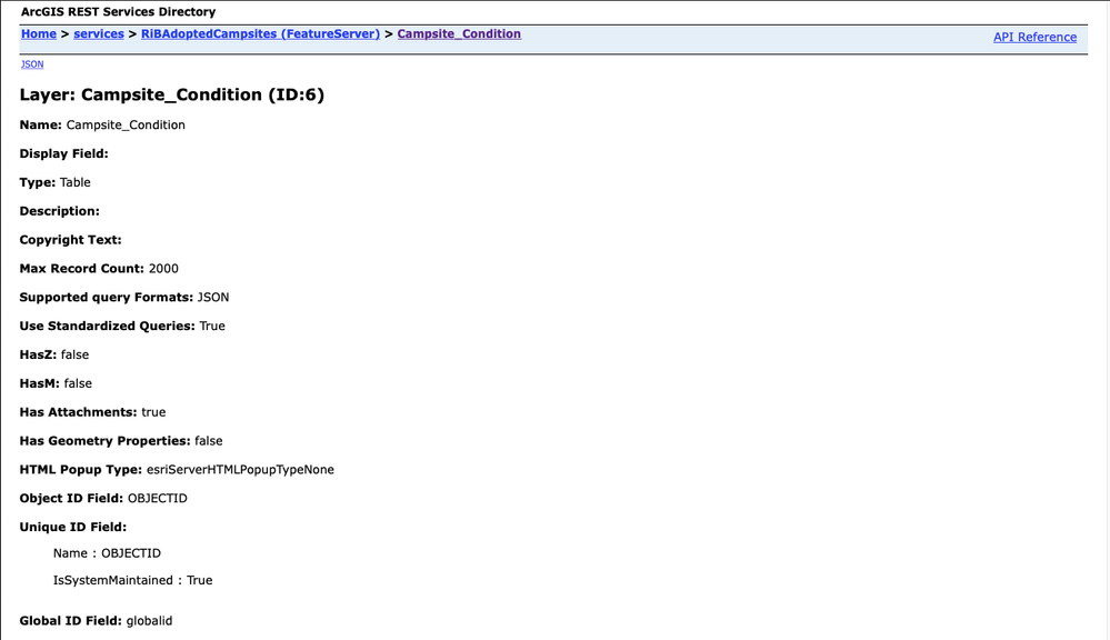

And here is the rest of the table that I am trying to link to:

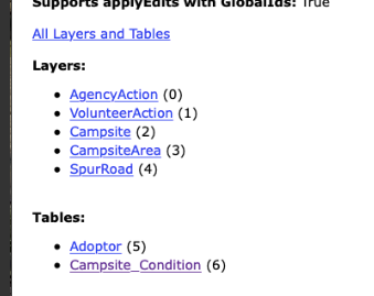

Do you see this section at all?  You left it out of your shots.
I think what will help you is make a new survey from file.  Publish that and then look at its service and compare.
GarrettRSmith
Hi
Here is a screen shot of what you referenced above:

In your form you have the main layer or form as Campsite_Condition in the settings page.
And then the repeat is just Campsite
But up above post your RC says Campsite_Campsite_Condition.  These have to match names.
Whats weird is your other post
No double campsite.  But this looks flipped.  Form_ID is the main layer so it should match Campsite (2) then the repeat is Campsite_Condition (6).  You got them backwards.  These all have to match.
Again I would do a new form from file and publish then look at this schema.
