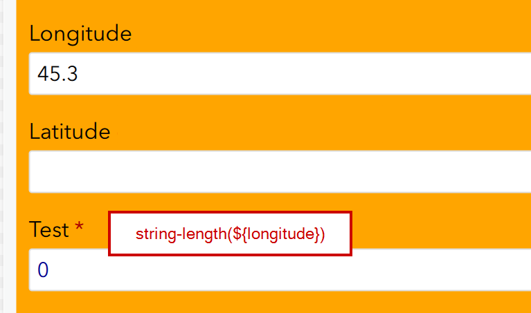

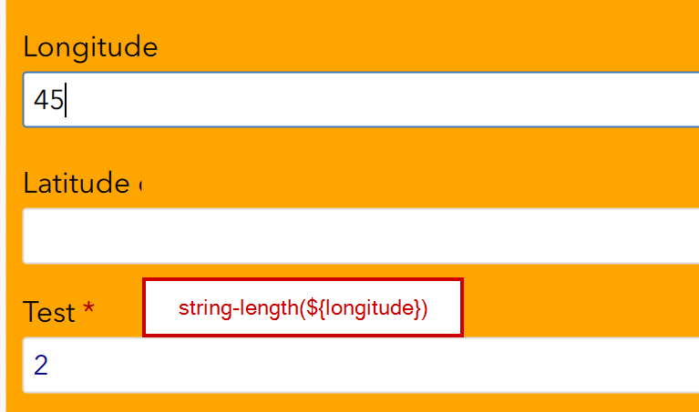

I'm trying to use an expression to evaluate if a decimal field is empty or not in Survey123. I have found this option :
(string-length(${latitude}))>0
Unfortunately, this returns the "string-length(${latitude})" portion of this expression returns a value of 0 whenever I try to enter a decimal value.
Example: decimal not working
example: integer works
I have tried these altenatives without sucess:
  • (string-length(number(${latitude})))>0
  • (string-length(number(${latitude})))>0.0
  • ${latitude} != 'NaN'
Can anyone help me finding a way to identify empty decimal fields ?
