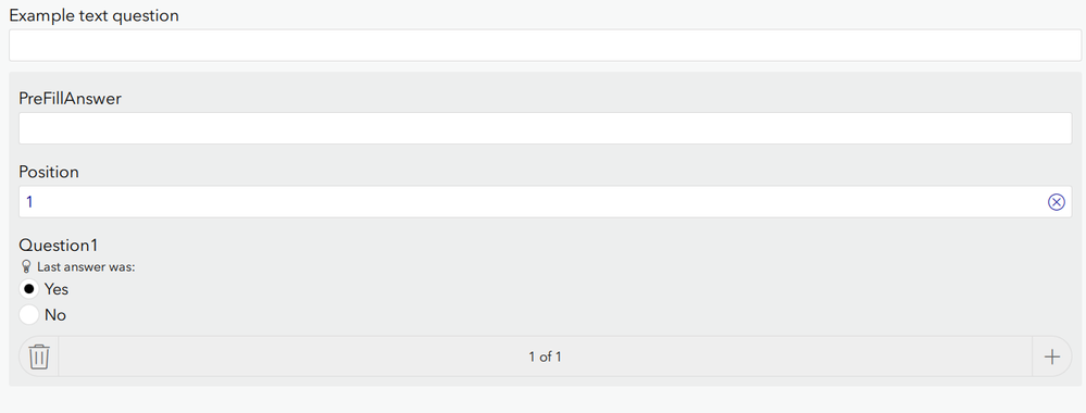

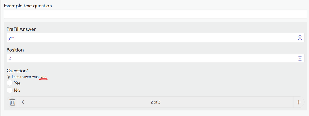

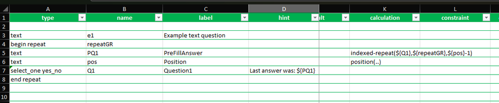

Neal_t_k
Another not so good option, but I figured I would share.  You can populate the "Hint" with the answer to the previous repeats answer. Screenshot 2025-04-02 165314.pngScreenshot 2025-04-02 165350.pngScreenshot 2025-04-02 165415.png
