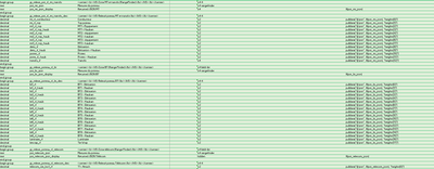

We've been using the Rangefinder under Survey123 for a short time. Our initial experiences have been superb. However, in a telecom inspection project, we're facing some challenges. We have about 40 data entries to collect in the field at most. This will vary from one site to another.
So, if all the conditions are met, we'll have to manage multiple data  taken by the Rangefinder. We're currently running into some problems.
First, when we add our 40ish fields in Survey123 Connect, Rangefinder only sees 29. Is there a maximum amount of data allowed when using the device? If so, any idea to make this relevant on the form and on the Rangefinder?
Second, to overcome this first problem, we have subdivided the data capture into 3 categories with a maximum of 15 fields to capture. Each category is grouped into a group and 3 different JSON objects have been created. Each of these objects should fill the fields. The problem is that all data captures point to the same JSON object without distinction. Are we limited to 1 single JSON in the same form?
Lastly, as with the Internet connection (pulldata("@property", 'online')), is it possible to know if the rangefinder is connected or not? We are trying to find a way to notify the user and manage manual data entry.
Connect version 3.20.63
Rangefinder TruPulse 200X
Thank you so much for any advise!!!!
